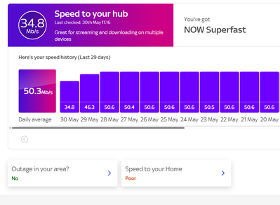

I'm having serious broadband performance issues and I'm hoping someone can help interpret the stats.
My setup is very simple. The Sky Hub SR203 is connected directly to the master socket, and the only devices connected are one mobile phone and two laptops with very light usage.
The router reports the following VDSL sync speeds:
  • Downstream: 44,516 kbps
  • Upstream: 535 kbps
The connection itself appears stable and isn't dropping out, but actual performance is extremely poor. Upload speeds are typically between 0.05 Mbps and 0.17 Mbps, download speeds are far below the reported sync rate, and latency is often several hundred milliseconds with occasional packet loss.
I've also run traceroutes and ping tests which show very high latency beyond the router.
The upstream sync rate of 535 kbps seems unusually low compared to the downstream sync speed, so I'm wondering whether this points to a line fault, DLM intervention, or something else.
Any thoughts or advice would be appreciated.

Thanks, Ive ran the diagnostics a few times, managed to get through on the online chat and they are going to monitor the network for the next 72 hours and give me updates via text.

Definitely an issue somewhere: on FTTC with 44Mbs of inbound, the outbound should be more like 10Mbs
As yours is only 0.5Mbs it's quite likely to be saturated, which is then a problem for normal TCP/IP functionality.
