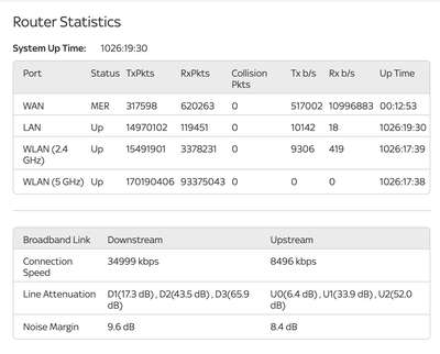

Router stats below:

@mikerowe1988 microfilters are not required if the voice line is delivered digitally via the hub. The noise margin of9.6dB is higher than the nominal 6dB and the spedd looks to be banded ar 35Mb/s which indicates a line issue. The account holder should call Sky and report the number of line drops. Whether Openreach will do anything depends on how long the issue has been going on and the guaranteed speed of the line. Sky can also arrange to get the master socket changed for a modern prefiltered unit which could help.

Huge thanks for your guidance here, you've been extremely helpful! Will get onto Sky now.
