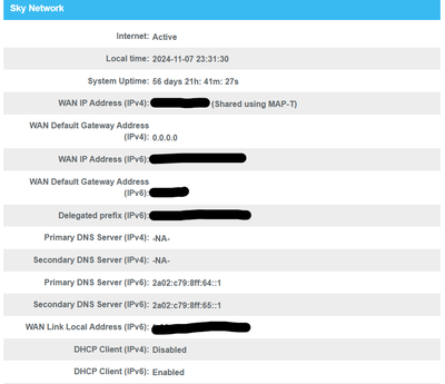

@reddevil00 wrote:IPv4 DNS is not available on the router and thus I am unable to use a lot of services (including this sky forum). This happens only on laptop devices connected to the main router, all other devices work fine. I have tried using Google DNS but it did not work. If I disable IPv6 on my network adapter or the router itself I lose connection to the internet (because IPv4 doesn't exist I assume). I tried prioritising IPv4 using regisry modifications but it simply switches to IPv6 because it is unable to detect IPv4. On rare occasion it fixes itself, and then goes back to being broken. Please help.
The results in this screenshot are perfectly normal and expected on the new Sky Max Hub running MAP-T. When connected using MAP-T, the Primary DNS Server (IPv4) and Secondary DNS Server (IPv4) fields will not be populated.
The Sky Hub proxies DNS queries to our recursive DNS platform over IPv6 only, this includes both A record queries (for IPv4), and AAAA queries (for IPv6).
Internally on your LAN, the Sky Hub should still be advertising itself to your devices as a DNS server over both IPv4 (via DHCPv4) and IPv6 (via Router Advertisements and Stateless DHCPv6).
Sorry this isn't much help for your issue, but based on the screenshot alone, it looks OK. If I had to guess based on the symptoms described, I'd say the client device is missing a DHCPv4 lease entirely?

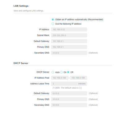

Message posted on 10 Dec 2024 08:16 PM
Re: IPv4 not available on router
Here is a screenshot of the settings
