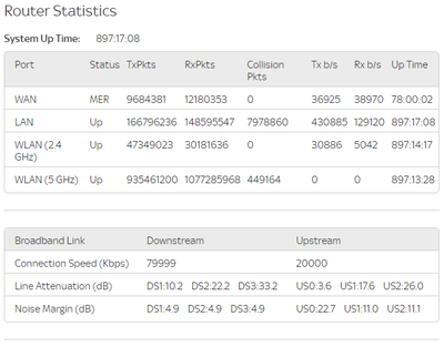

Message posted on 16 Apr 2024 01:52 PM
Re: G.Fast, Draytek Vigor 166 and Netgear Orbi
It doesn't look good...
Message posted on 16 Apr 2024 02:02 PM
It is a nice line but the distance is about 250-270 metres from the cabinet suggesting that G.fast could operate at 160Mbps but with low noise margins of about 3-6dB at that 160Mbps speed if it even makes that speed.
I think you'll find homeplugs, especially the ones you have picked and the distance from the telephone line or electrical ring would indicate an issue when using the HomePlug technology concurrently with G.fast.
