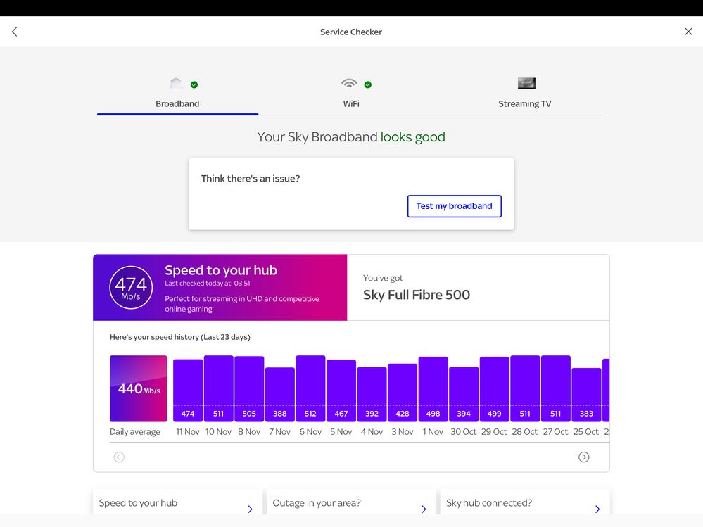

Message posted on 11 Nov 2025 01:40 PM - last edited: 11 Nov 2025 01:46 PM
Re: Fibre 500 new install
@Tom+Shinkwin contention on a shared connection simple.as that the speed will vary by time of day.
For example here are my own results
Sky's tests

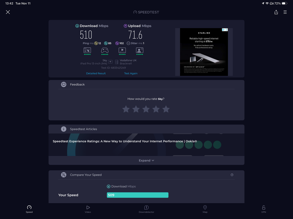

Speedtest run in the last 5 minutes
On my connection Sky's speeds are very conservative as speed tests are usually 500Mb/s or there abouts.
