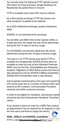

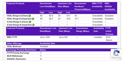

@AdamW1 we have seen cases where people have been sent leaflets but couldn't order. We have also seen orders cancelled as Openreach locally knew that the database was wrong but yours is a first that got that far.
Thst Sky decline to pay extra installation costs is not unexpected.. Whether BT/EE would is unknown but it is worth a try. However it is also worth checking the Openreach database for your full postal address here Openreach Checker. If you would like help in understanding the entry post thectable plus the first 3 lines of the notes after removing the reference to your address.

Avatar for AdamW1
This message was authored by: AdamW1
Re: FTTP Order Cancelled - What next
Hi,
Thanks for the reply - see below
