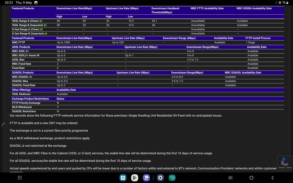

@Aleksandrorlov  If you fill out the form below and post a screenshot the community can help you understand what work will need to be done. You will need to hide the private information that is in the top-left corner before posting the screenshot.

Re: FTTP New Order and Openreach Visit
@Aleksandrorlov
'OH feed with no anticipated issues'
So the optical cable will come from a nearby telephone pole to the eaves of your property, then vertically downwards to just above ground level where the CSP (external box) will be located.  From there you have some choice over cabling route of the optical pigtail to an entry point: that's likely to happen on the activation date because it requires access inside the premises and permission to drill.
