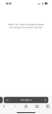

I have just had a Versprung EV charger connected to the house, every time I try to add the charger it tells me it cannot find the WiFi (the range and signal isn't the issue) so I'm assuming it's to do with the synchronised 2.4/5ghz, however when trying to log in and un-synchronise (and rename SSID's) as soon as I try to click 'apply' it tells me the below:

Using Safari, particularly over WiFi, typically isn't successful for Hub administration.
