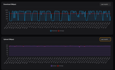

Hello Sky Forums,
Product: Sky Full Fibre Gigafast
Originally thought it was something to do with our own hardware as do run our own router and network switches but the same was happening when we plugged a device directly into the ONT. For the time being we have plugged in Sky's own router so we can gather the stats needed using the "checker" on the My Sky app.

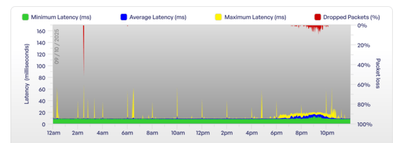

@TheGarner Will not make the slightest difference as sky check only once automatically in a 24hr period, so you need to do all the checking yourself with the sky Hub. Just be sure to screen capture your checks!
Message posted on 01 Oct 2025 10:34 PM
Re: Download Speed Issue (Evenings Only)
Understood - We are doing manual checks and taking screenshots of all of the data. As it's getting a bit stupid now when the internet speed goes down to a low 8Mbps.
