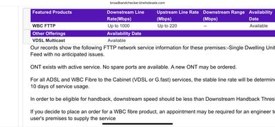

Is this correct?
Re: Doi need an engineer?
@Baxter93
The relevant line is
ONT exists with active service. No spare ports are available. A new ONT may be ordered.
So they appear to think that while there is indeed FTTP, it's already at maximum capacity within the building.

Could you explain that? As it's a single property with nothing else in use?
No, I can't.  You'd expect that message for an MDU (multiple dwelling unit) rather than a single property.
