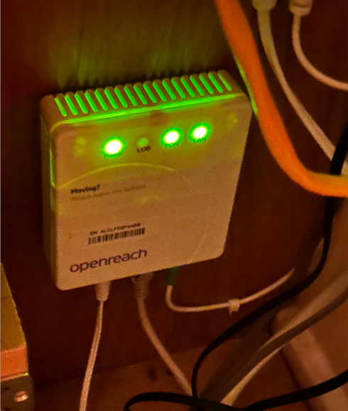

ONT box shows three static lights (see pic) with ocassional blinking, router shows either voice & Wifi lights amber, or post reset Power & Voice light, no Internet or Voice whatsoever. Router has been hard reset.

@mariodecristofano the lights on the ONT indicates that the unit is powered receiving an optical signal from the exchange the fact the LAN light flashes indicates data is passing. When you took the stats the hub had no connection so they tell us very little other than the hub was restarted just under 10 minutes before.
There is a fault someshere given you have had a working connection would seem to rule out an issue with the coding of the ONT - the fibre carries data for all users on your local connection and the ONT needs to be told which data is yours. That leaves an issue at Sky's servers or more likely an issue with the hub. If the hub is spontaenously restarting and loosing settings that would seem the most likely candidate. As you are already talking to Sky it is better to get back in touch and check with them as to what they propose.
