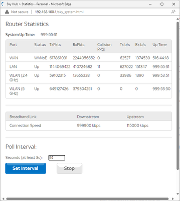

You could log onto your hub using a ethernet device and go to the stats page (as below) then start a download then wait for 10 seconds and post the stats

This message was authored by: simon194
Re: Cant locate the speed checker
@cookiemonsteruk wrote:
@chrismckay
Agreed. But the sky hub doesn't captur line speed as its own vdsl modem is bypassed by the ont but the eth device will be 90-95% of line speed
The connection speed  on FTTP is now shown in the stats following one of the recent firmware updates on the SR203.
_____________________________________________________
@simon194
Not sure if that figure isn't just carried over from the profile.  In addition according to your own stats only 1.37  Mbps has been utilised.
