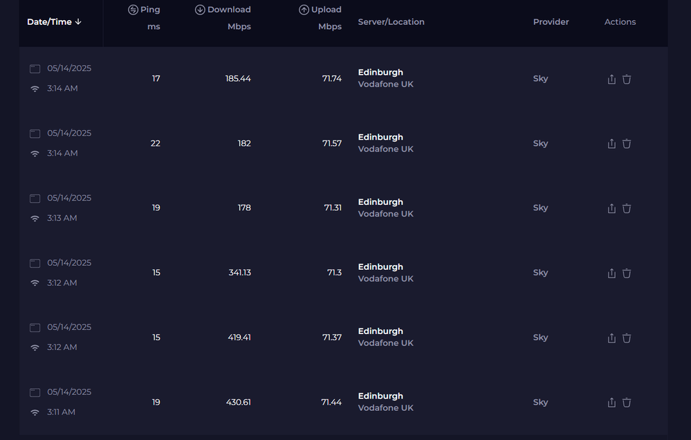

If I log onto my router and change the Ethernet setup from Gigabyte ethernet to Fast ethernet, wait for the router to reboot, change it back to Gigabyte ethernet and wait on the router rebooting again, i'm consistently getting above 400mb downloads for a whole 10 minutes before it drops back down again to 160 average. This is happening every single time I try the same process..... (My daily average speed to the router, according to Sky is 400+)

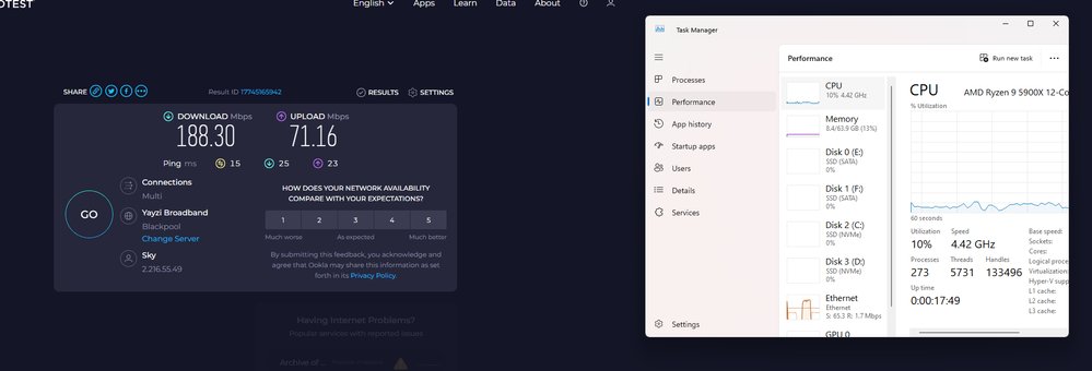

Pre reboot test, with machine performance.....

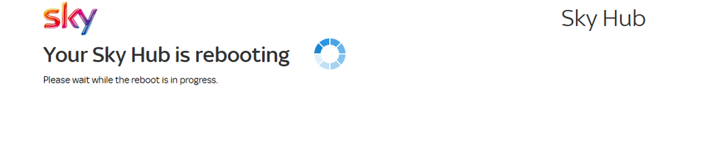

Internal router reboot...

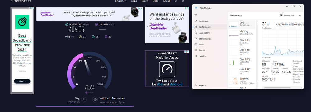

Download speed after reboot with machine performance.....
After roughly 3-5 minutes every time it will cap the speed to around 160-180+....

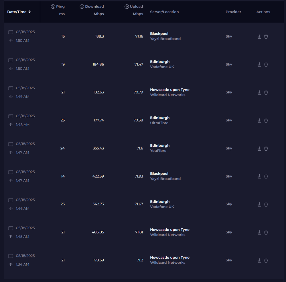

Test results on a server cycle showing the result before the internal reboot, the gap in time whilst doing the internal reboots after changing settings mentioned above and changing back. It also shows when the router is deciding to cap the speed. I've now done this test about 10x and the same results every time.....
It's all pointing towards the Router for me....
