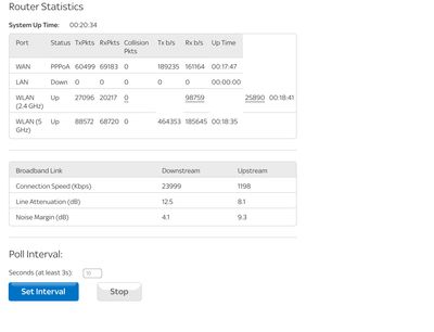

Attaching a screenshot of my router stats hoping someone can offer some solutions. Thank you !

You are on maximum speed for adsl copper to the exchange

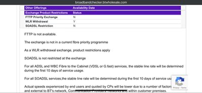

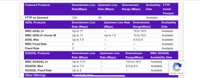

Could you enter you full address below and post the table after removing your address from to see if theres anything faster with a guarantee
Message posted on 25 Apr 2024 06:42 PM
Re: Broadband being consistently rubbish recently
Thanks for your reply and translating what my router stats mean!
I've been with sky for a while now and it's never been this bad - the connection dropping in and out making it basically useless yet my service status in the app telling me it's all good doesn't make any sense.
Screenshots below

Is there nothing above the fibre on demand ie vdsl are you in a rural area
Your stats show 1 drop but looks like you resetting the hub or turning it off

The drop you noticed was probably me going through the online troubleshooting for the umpteenth time and restarting the router.
Part of the problem is that it isn't showing amber - it all looks as if it's connected, showing green. The app service checker will say everything is all good. But the reality will be that it just isn't working so I don't know what to do about it.
