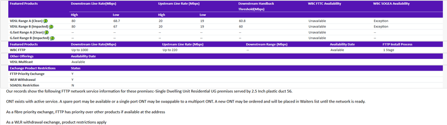

@Giscott
Putting the address into the BT Wholesale Availability Checker should indicate which broadband provisioning type is applicable.
Avatar for Giscott
This message was authored by: Giscott
Re: Broadband Fibre Cables - use Openreach
@Giscott
ONT exists with active service '
So for an ISP switch there shouldn't need to be any new cabling.
I haven't seen that reference to a 'Waiters list' before, though.
