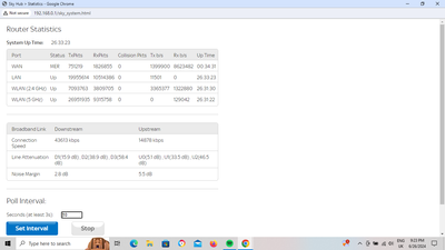

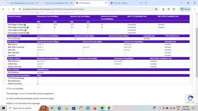

We've changed nothing in terms of set up in the last few days, and the drop only occurs for a matter of a couple of minutes before it's back up and running.  I've attached a couple of images based on similar posts so hopefully it can assist on a solution.

The broadband line is below hand back to Openreach, noise on the broadband line and likely at the cabinet end of the connection. Handback is 44Mbps on the Openreach sheet.

@Carbon_Dioxide
The signal has deteriorated at the number of wavelengths shorter than the full length of the broadband line. by a long way .
This is because the noise margin would go up at longer lengths and has gone down below 3dB and speed dropped owing to good signal but deterioration in signal at its wavelength number less than full line length by a long way. Longer length line faults show a deterioration in the lower frequencies and increased noise margins.
This impacts speed (lower frequency signals usually, dry joint pass higher frequency) but not signal quality based on attenuation, eg: speed drops because a joint on the line close to the transmitter cannot maintain quality at the lower frequency. Eg: the lower frequency cannot travel along the broadband line, indicating a shorter distance to the fault, eg: and the loading impedance is lower in value (high frequencies pass but lower frequencies do not). Slightly open circuit fault with higher capacitance.
The base of frequency is ratio-dependent, the higher the ratio the higher the noise margin and drop in signal, the noise margin going up shows that the signal needs amplification generating noise but is still there and speed then drops due to amplifying the noise further lengths on the broadband line have this characteristic, that has not happened; high noise margin means more amplification for a good signal but at a lower signal level closer to the endpoint (premises).

Re: Broadband Drops Regularly
The second joint point should be checked, eg: the fault is not at the cabinet it is slightly further out, say about 5 metres in length I estimate. from the cabinet at the PCP.
Recommend router stats show all their noise margins for the bands (D1, D2 and D3), and adjust the lower D1 band to show a higher noise margin in this case at a higher level indicating lower frequency deterioration for diagnostics for AI algorithm for fault finding in the case above.
