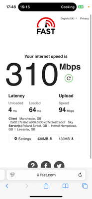

I am not sure how to do a screenshot from the laptop so I will do the speed test from my iPhone and do a screenshot and send it to you now.
I understand this might not be as accurate as Internet, but I will try and sort that out later once I know how to.
Re: Broadband 900 speed problem
@Qamar
A speed test on a wireless device is largely 'testing' the local WiFi: as I frequently post, it will be zero Mbs on the other side of a few walls.
