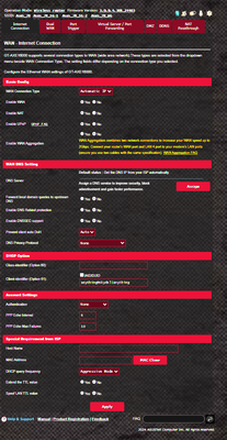

Hi
Reading up and seen a few posts with similar issues.
After trying the answers supplied with other questions, i dont seem to be able to get this Asus up and running.
The settings are fairly straight forward.
I have put in Auto IP - option 61. In the UK so I have the anything@skydsl|anything
I read sometimes that swapping can cause an issue, so i have saved settings and will try and connect the sky hub and then retry the Asus.
i will get a screen grab if that helps?
Anything i am missing?
TIA

Hi @Chrisee
Thanks for the reply.
I have read through and cant see a solution here. Dont think this user is on fibre.
My ASUS AXE -16000 is plugged into the ONT direct to my 10GE port
