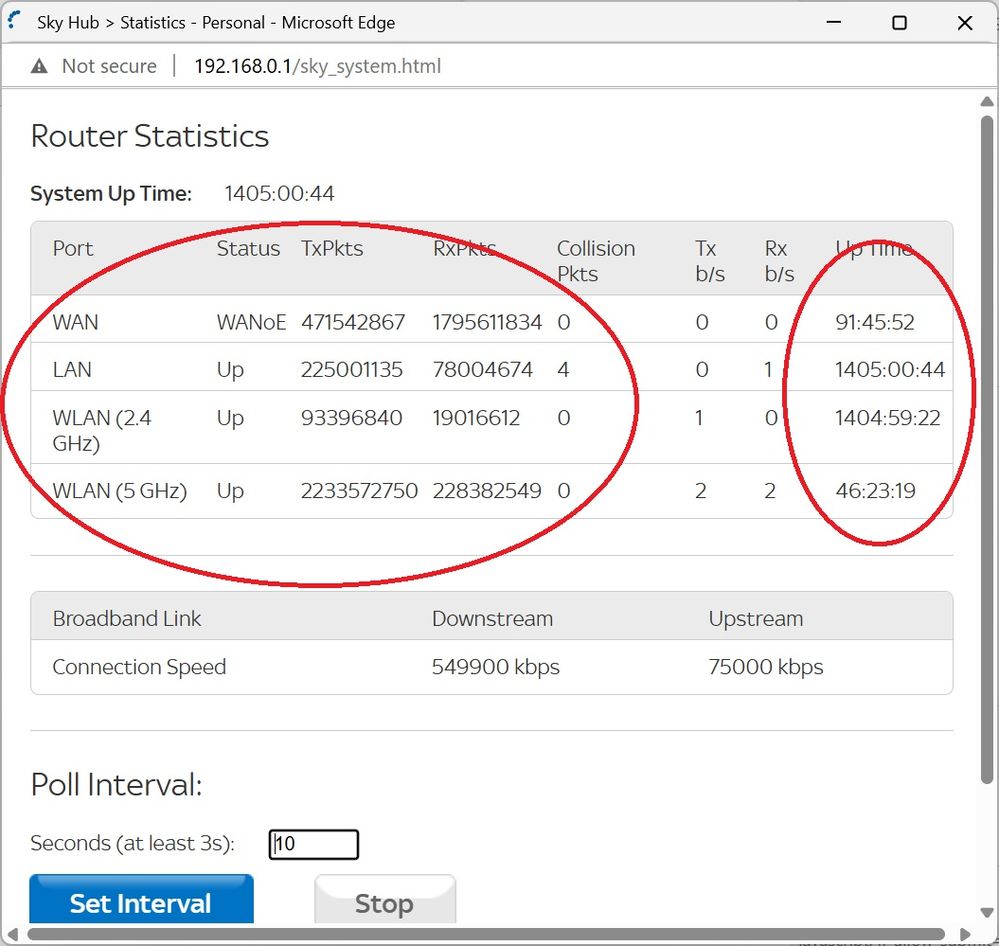

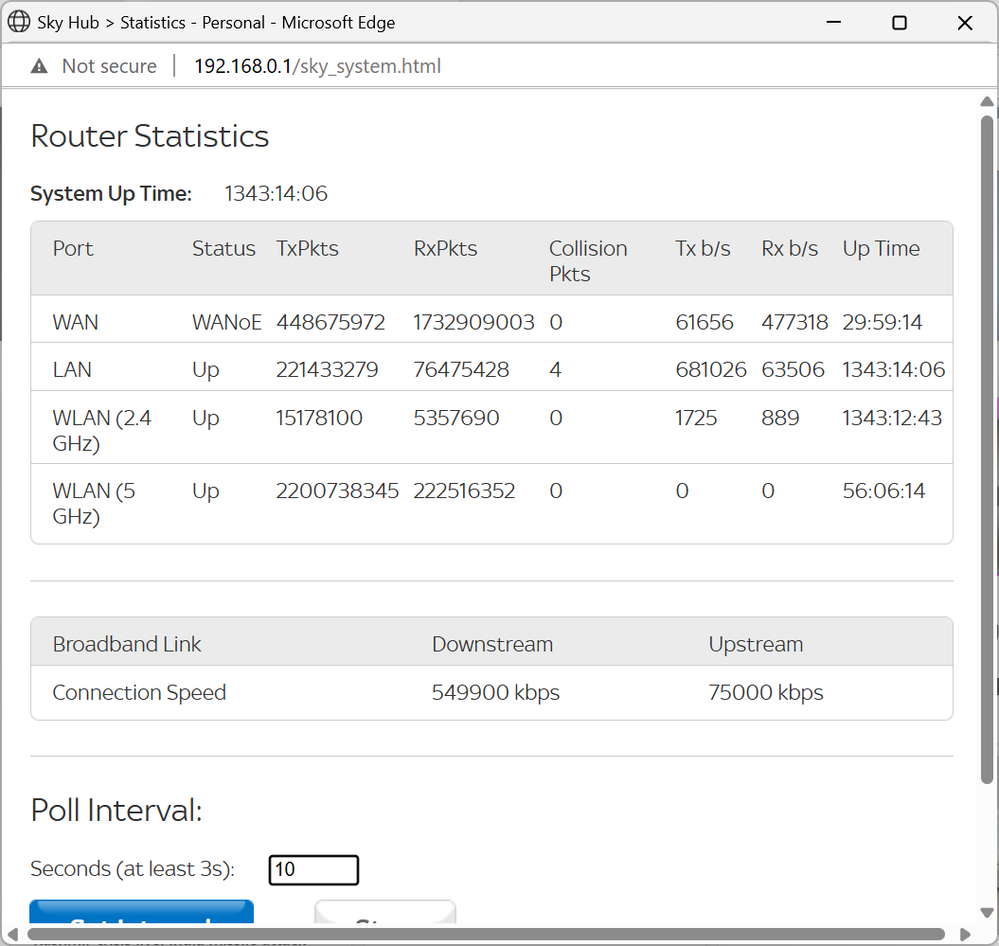

Message posted on 19 Jan 2026 01:54 PM
Re: Another dropout problem
@JimM1 @This is what happens when I try to bring up stats with the instructions you gave
Message posted on 19 Jan 2026 05:26 PM
@Kerry187 Sorry there is nothing attached to see!
