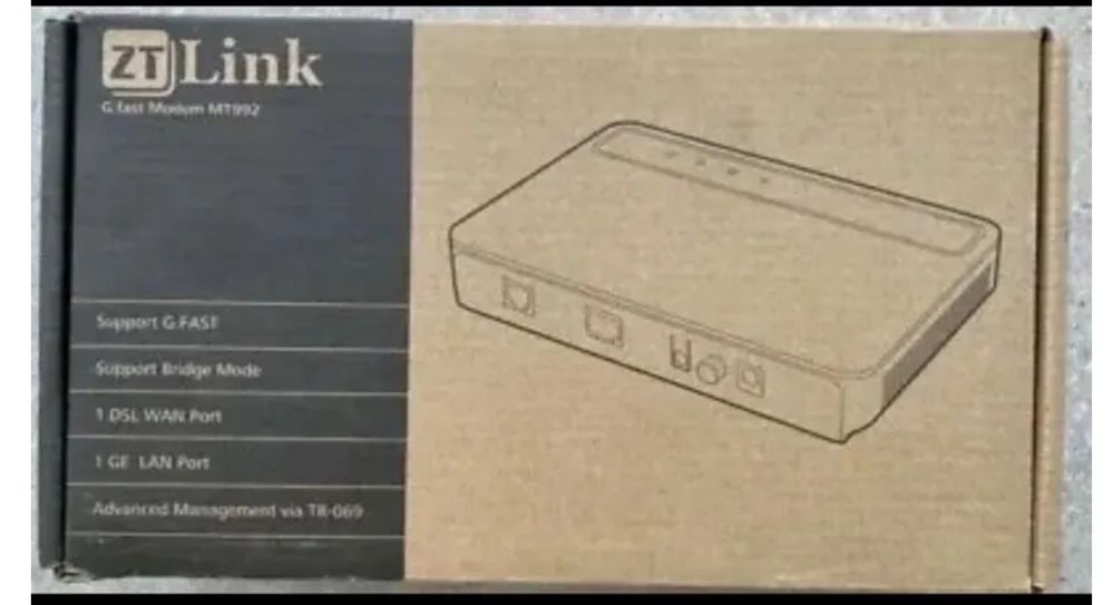

Please can you confirm if I can run the ZTLink MT992 G.Fast Modem to replace my SR204? Is this the
Openreach Huawei MT992 or basically the same as, or does it need to be a specific Huawei MT992?
I'll then set up the Unifi to send details on Option 61.
Many thanks
Message posted on 11 May 2024 11:38 AM
Re: Adding Unifi to G.Fast - Keep or replace SR204 ?????
@jsstevo no idea to be honest but a quick search turned up this link https://www.ispreview.co.uk/talk/threads/g-fast-modem.36967/page-2 where someone says the chipset is the same as the Huawei modem. You are correct that it is the router not the modem that handles the authentication.
