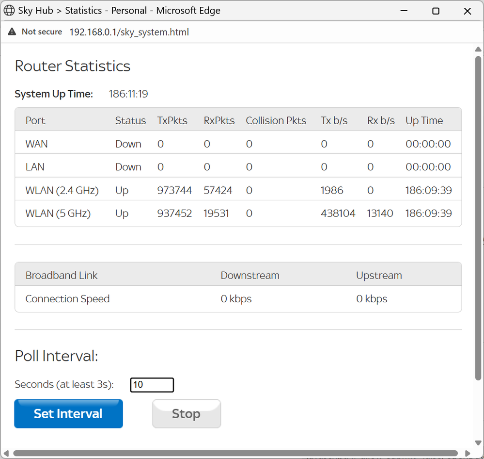

@Jashan The 5Ghz band on the stat's has always been a little strange with function ie, will show packets in/out but may not shoe data updates but you do know that is what is happening, the 5Ghz timer reset will admit have seen it only do that once so below a couple off pictures, are you finding that the reset is regular once per day for you?
Stat's screen 1 all up back April time 2025..
Stat's screen 2 know idea why the 5Ghz reset it's self May 5th 2025
Stat's screen 3 5Ghz still running May 7th 2025, and a wan drop reset could be anything at all for that one.
Stat's screen4 from 9th May 2025
Stat's screen 5 from May 13th last one i had before retiring the SR203 back to it's box! 5ghz looks like it reset itself again!

@Jashan Cannot think off any particular reason that the 5Ghz timer would reset back, but will fire up the SR203 and play with it, had it on power couple weeks ago for an OP with some issues, not wan connected but the 2.4Ghz/5Ghz timer bands ran ok! Picture is below!
From the 13th Dec 2025 just powered no wan connection! May have been to FW update to the latest version!

@Jashan Tried to see and work out why the 5Ghz reset's itself nothing stands out, so did a test disabling the 5Ghz AP to reset and re-enable and have recorded the screen captures to be sure what happens, and the reset's as applied!
Picture 1, my SR203 but as normal settings with split bands.
Picture 2, the runtime so far!
Picture 3, disable the 5Ghz to reset the timer!
Picture 4. 5Ghz back on timer now running again from the restart!
Picture 5, showing the AP off!
Picture 6, all the sky Hub details if needed for comparison! FW is the latest as far as i am aware!

@Jashan No both off those are fine, because the Hub is not WAN connected it defaults to that setting on mine, the 4 boxes ticked, i unticked the first on to clamp the 5Ghz so it killed the wireless wifi signal and that reset's the timer back to zero, re-enabled it to start the timer off again, the 4th box allows the hub to do Split bands, so i have the 2.4Ghz and the 5Ghz on different names, ie the 5G after the name, and allows the selection at device level to go at the band full speed and not drop back onto 2.4Ghz if it feels like it!
