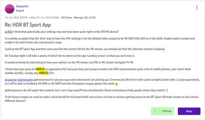

@Anonymous wrote:@tarbat @No BT Sport Ultimate uses HLG
That's not what the BT employee (DarrenDev BT Sports Expert) said on their support forum at https://community.bt.com/t5/BT-Sport-on-TV-Online-player-or/BT-Sport-app-Amazon-4K-Firestick/td-p/2092171/page/2
And at https://community.bt.com/t5/BT-Sport-on-TV-Online-player-or/HDR-BT-Sport-App/td-p/1969785/page/19

BT sport use HDR10 as their format.
Message posted on 03 Nov 2021 09:40 AM - last edited: 03 Nov 2021 09:55 AM
Re: Software version update
@lettice wrote:BT sport use HDR10 as their format.
Thanks for confirming.
So @Anonymous that explains why the BT Sports picture on Apple TV is brighter than Sky Sports:
- BT Sports, using HDR10(PQ) has a reference white of 203 nits
- Sky Sports, using HLG, has a reference white of around 140 nits on the Glass TV.
