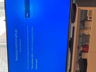

Hi. I've managed it. Go to settings and when you get to remote settings and it tells you to type in model .... it won't find it so it will try options 1-20. Option 8 is the one that does it

Model number: 58HK6100U.
I definitely had 20 options.
I pressed settings: set up: remote control: I then click the middle option of sky Q remote: control your tv: that's when I typed in Hitachi then "I know it". Then start typing it in and click "my model is not listed". I then got ... "we're trying the settings that are most likely to work first. This is setting 1 of 20 - to test it try changing the volume. Did this work" I kept them clicking "no, try another" until I reached one that worked

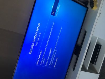

Re: Sky q remote problems with new hitachi tv
Tried to follow your instructions, when trying each current I only get 13 options to try and none worked.
This message was authored by: LisaD88
