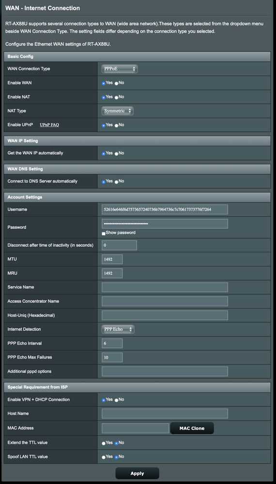

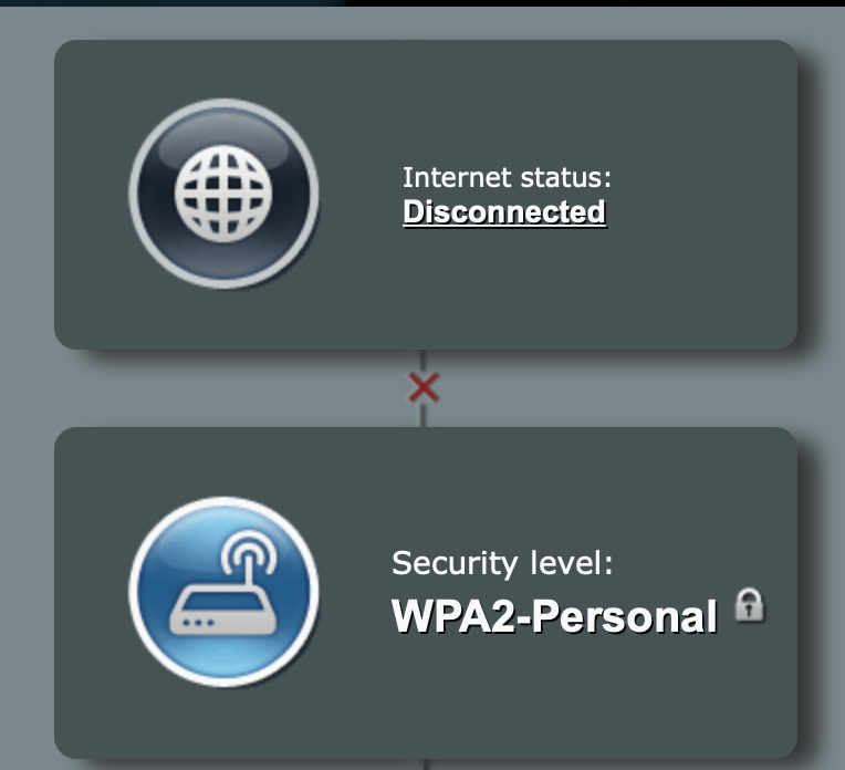

So here is the latest...
Connected ONT to WAN port on Asus
Ran set up on Asus.
PPPOE select and when its asked for username and password put in
52616e646f6d7573657240736b7964736c7c70617373776f7264
And
6.14.1aN_UNI|PCBAFAST2504Nv1.0
But it is still not connecting
Message posted on 15 Feb 2021 04:38 PM
Re: Setting up Asus RT-AX86U
@Skull+Treaty pictures and update above
