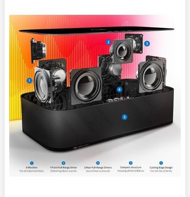

Have you seen this photo that was around a while ago ? I found the layout interesting
if @TimmyBGood is around he has good knowledge of the soundbox and may be able to offer some thoughts
