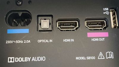

So you've put a high speed HDMI cable from the Q box and in to the soundbox input
then another HDMI out of the soundbox and in to your TV
maje sure you haven't got your soundbox input / output the wrong way round (see my guide below if that helps)
black is the input in to the soundbox
pink is the output out of the soundbox
Then definitely selected HDMI on the soundbox menu (make sure it hasn't slipped to optical or Bluetooth)

Yes. To do the reset - do this
- Switch off the power to your Sky Soundbox at the wall and wait for the lights on the front panel to go off
- Press and hold down the power and volumedown buttons together. Don’t release them
- While you’re holding down the buttons, switch the power back on at the mains
- Keep holding down the power and volume down buttons for at least 10 seconds until the red light on your Sky Soundbox comes on and then changes to amber
- Release the power and volume down buttons
- After 5-10 seconds, your Sky Soundbox will make the boot-up sound and turn itself back on. The light will go green
