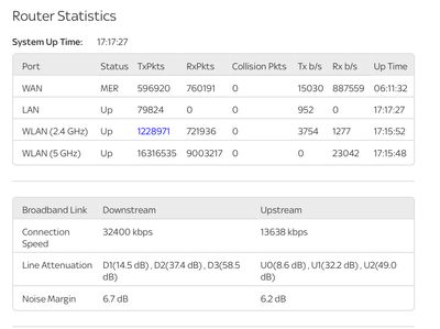

Message posted on 15 Jan 2022 09:42 AM
Re: New contract: new problems!
Message posted on 15 Jan 2022 09:48 AM
Thanks! I copied and pasted but it just kept giving me a bunch of errors when I tried to post it here.
I tried a screenshot but I don't think that worked.
Message posted on 15 Jan 2022 10:34 AM - last edited: 15 Jan 2022 10:38 AM
The broadband connection is on an 80/20Mbps profile but the speed is below 40Mbps downstream with a slightly raised noise margin but more importantly, the downstream speed is below your guaranteed minimum speed at a speed of only 32.4Mbps. Either run a line test or call Sky directly to get an engineer allocated to investigate the line fault to the cabinet.
Engineer came this morning and changed out my hub and socket.
Speed had been capped at 29.9999 for a while. Been uncapped now and running at 46 download. Escalated to openreach as they believe the speeds could be upped by a further 10-20mb. Good news!
