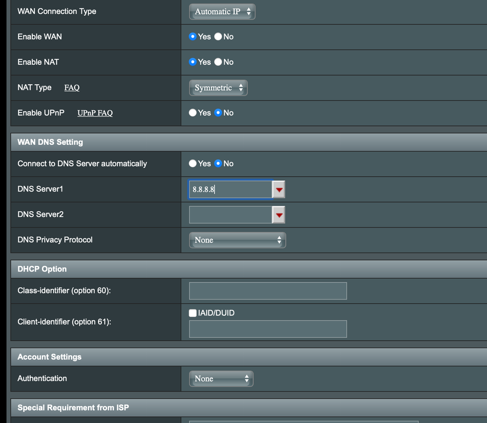

Even though you are not connecting to a standalone modem you can connect your setup as described by myself and have double NAT and from what you have stated about the applications you are using it will work quite happily. The Sky router would stay in place, of course, currently.

This message was authored by: mae-3
Re: New 3rd Party Router - To Improve WiFi
@rozel
This is the configuration for the WAN port when connecting to the Sky router:-
