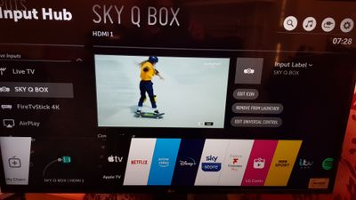

Hi
Thank you I tried "carnival Row" and it gave the same result as "snowpiercer" on netflix
atmos is activated via the TV app but not the sky app.
I swapped the sky box hdmi lead from the non earc hdmi on the TV to the soundbar hdmi in the only difference this made was change the source name so I guess it is the sky box.
The hdmi out on the soundbar is connected to the TV via the arc hdmi which I'm told is the correct way to have it.
I guess I will have to change my future film purchases as it seems that the only way to get the full benefit of my new toys is to get my films directly from amazon/netflix as it also appears that I cannot install or view via the built in browser the sky store app on my TV and attempts to cast this from my phone have failed.
The all in one solution seems to have been superceded by the TV itself which is a shame because I did like having my film library in one place..
Mike..
