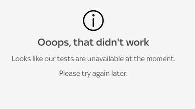

I try to initate the broadband check and get this. Is there anything I can do about my high line attenuation despite being within half a mile of the cabinet?
- As @Chrisee suggests your line may take a longer route than your neighbour as your numbers suggest.
- You need to keep trying the test and if it is not working contact Sky.
