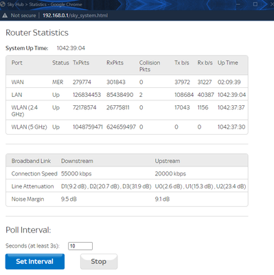

Definately a line fault smewhere
You 2Mbps below your guaranteed minimum
The syslog confirms dhcp lease renewal failures
And your noise margin is too high
Call sky on 150 from your landline or
zero three three three seven five nine one zero one eight from any other phone to book an engineer appt. Get back to us for escalation if you have difficulties getting thru

Can you post your router stats
https://community.sky.com/t5/Broadband/How-to-find-your-Sky-Broadband-router-stats/m-p/2855717#M1014...

Hi cookiemonsteruk,
Thanks for the reply, yes sure, my current router stats are:

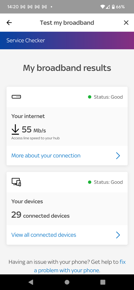

The MySky broadband checker results show all statuses as 'Good'. I have attached a screenshot.
Thanks very much
Re: Fibre broadband dropping out frequently
@Talk2FrankUK

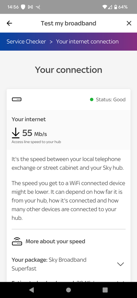

Click on more about your connection and post

Photos attached. Thanks again.Screenshot_20220225-145632.pngScreenshot_20220225-145643.pngScreenshot_20220225-145653.pngScreenshot_20220225-145706.png

Hi all,
I'm getting a similar problem. In January I logged an issue with Sky that the BB was dropping out regularly when I was trying to work at home. On that occasion a Sky engineer came to change some connections. We had a faster connection but still experienced some difficulties. However, I haven't needed to work at home until today. Throughout the morning I had repeated drop-outs of internet connection. I logged onto Sky.com, and this resulted in a BT Openreach job raised. Hopefully they come to the same conclusion. For information I ran a hub diagnostic check and found the event log. I've plotted the VDSL2 link down events (only available for the last 5 days though). There appears to be a significant trend during the morning.

@Talk2FrankUK @cookiemonsteruk  just in case you don't get a notification about the above post. Thanks 🙂
