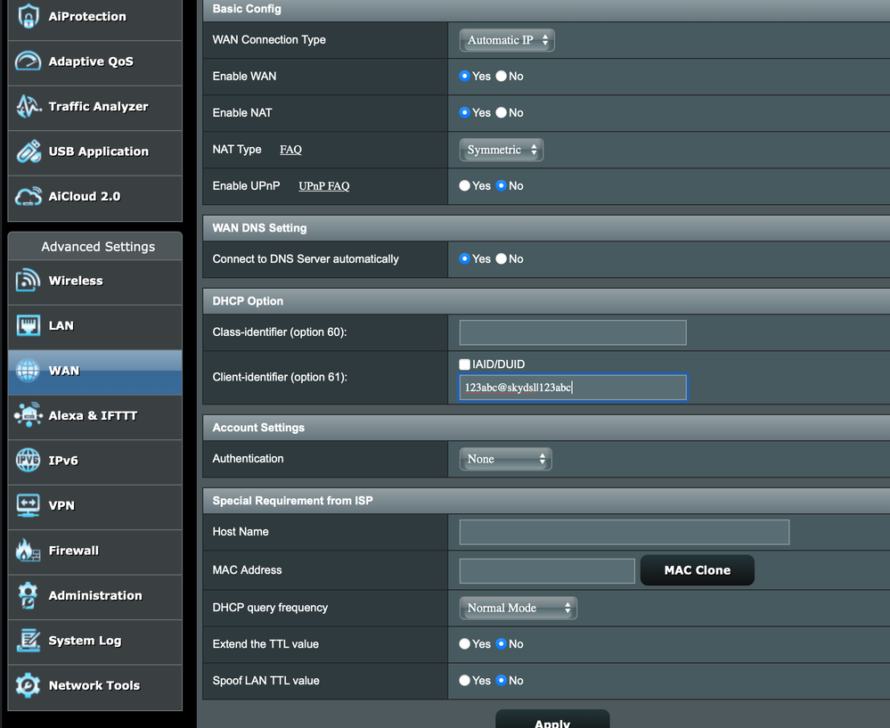

Even though DHCPv6 PD works on its own it is highly recommended that you fill in the details for DHCP Option 61 as well for this Asus router per Sky's recommendation.

For DHCP Option 61 and its parameters should be as follows and DHCP should be 123abc@skydsl|123abc
Message posted on 19 Sep 2021 10:40 AM
Re: ASUS ZenWiFi AX
That sorted it, thanks @mae-3. I didn't need to change anything other than the DHCP string, so maybe I'd copied and pasted it wrong before...

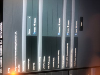

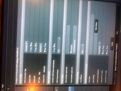

I'm hoping you can help. I have recently had FTTP installed and have purchased ASUS ZenWifi but after following your settings.
I still can't get them to work. The ASUS is currently plugged straight into ONT. but I get a red light.
please see settings below.
have I missed something?
thank you in advance

Just checking the client identifier option 61 field. The format is
Anything@skydsl|anything
Yours looks like anything@skydsllanything
The bit after @skydsl is a pipe seperator |

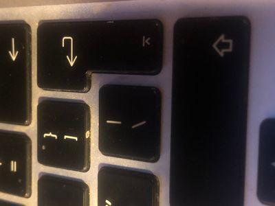

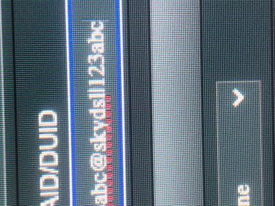

I think I'm using pipe separator.
just to be sure.
see images below | Symbol to the right yes?
Message posted on 17 Oct 2021 01:41 PM
Re: ASUS ZenWiFi AX
Thats much clearer now. That page looks fine don't see why its not working try :-
