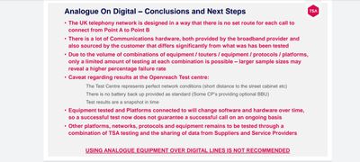

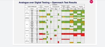

The association that represents the technology enables care and telecare industry (TSA) is recommending the providers of such care line/telecare devices and services to upgrade them to compatible digital alternatives rather than using ones that communicate through a traditional analogue phone port (e.g via the ATA).
Below is screen shots of the bulletin from TSA available at: https://www.tsa-voice.org.uk/downloads/events_2022/tsa_2022_surgeries_round_3_-_november_2022_final....
And some of its members appear to be coming dangerously close to outright lies: in response to this thread I was looking at one provider website that boasted about the 'battery backup' of its product while entirely failing to mention that an ISP router (and an ONT in the case of FTTP) also require such backup (with significantly greater load capacity) to have any functionality in the event of a mains outage.
