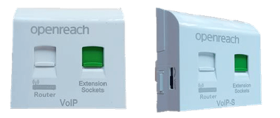

When on copper wires the Drop wire from outside went into OpenReach box in my hall with a normal phone socket on it, out of the back of of it there are two seperate cables one with a standard phone socket on skirting board in lounge the other in the study. All 3 phones are donkies years old BT Decors.
Engineer removed the drop wire from the OR first socket he then took a phone lead took one of the plugs off and wired it into the first socket where the drop wire had conected and the plug went into the fibre router phone outlet.

Certainly: that's 'Voice Re-Injection' (VRI)
VRI could have been offered as part of a standard installation (Openreach even developed a specific master socket faceplate for VRI on digital copper circuits) but as @Mark39 indicates, it just doesn't happen, mostly because Openreach don't want to be involved in support for extensions and cannot afford the additional time taken if the national FTTP rollout target is to be met.
Householders can choose to investigate and commission VRI from a private contractor if they wish, with the caveat that care must be taken not to risk a crossover with a contiguous external metallic connection if one is still in place at the address.
