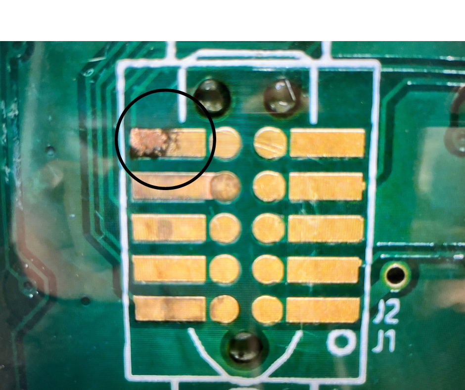

I work with electronics and this morning I cleaned the battery compartment with isopropyl alcohol, put new batteries in but no joy.
This is the first time we have had Sky TV so unfortunately, we do not have any other Sky equipment here.
By twisting the remote... does this mean there could be dry solder joints? I might take it apart and reflow the joints.

Below is a photo.
I removed the board from the remote and put it under my microscope.
The pad, which is circled, was half burned. In the photo, I had already started to clean it before I thought I should take a photo for this forum.
I continued to clean the pad. And tested continuity around the board. All looked good.
Put new batteries in, and bingo, tested with the puck, and working fine.
