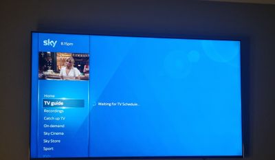

Waiting for tv schedule
Hi, does anyone have a long term solution to the there being no TV schedule, or the waiting for tv schedule message,I'm having to reboot my box multiple times a day sometimes and surley i shouldn't have to keep doing that surley, it comes back after rebooting then will go again , and have the waiting for schedule  message again sometimes an hour later , sometimes a day later,it's driving me crazy!! I had an engineer recently because of an issue with the mini box and I mentioned it, so he replaced the main box hoping that would help ,although he didnt seem to be very aware it was a common issue with others ,but it still doing it all the time, I've not renewed my contract unsure if to bother after 16 years, try maybe BT TV. Thanks, any suggestions very welcome.

Just something I noticed that this happens if any of the boxes are on standby setting 'none'. The tv schedule gets stuck and only comes back by power cycling the box. When I put them all back onto the same mode, in my case I used eco. Once I made this change and power cycled one more time on each box the issue never came back. Also check your storage isn't full, my boxes became very unresponsive when the memory was at anything over 80% full. Clearing up old recordings seems to get things running again for me.
Hope this helps.

I had exactly the same issue. Solved it by performing a software update on the main skyQ box and updating all connected mini boxes afterwards. The re-connect the mini boxes.
