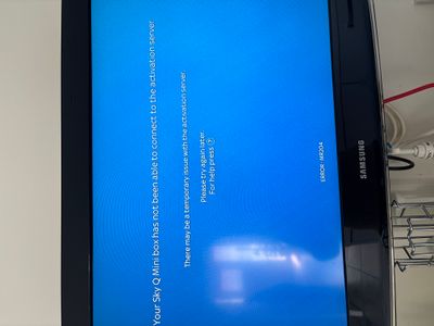

Hi my sky q mini box isn't working
Hi @Naheed2
First try rebooting the main Q box and then when this is completely back up and running reboot the mini.
Reboot the mini as above.
If the mini still does not connect reliably try a Network Reset on the mini.
Network Reset found in mini Home - Settings - Setup - Network.
Highlight Status and then select Reset on the right hand side. Follow instructions to WPS with main Q box.
You will be asked to press the WPS button on the main Q box (not the mini as the Network reset will start the mini WPS automatically).
If you are on Sky Broadband and the Router is nearer to the mini than the main box then you can try pressing WPS on the router instead of the main Q box. If you do this make sure you press the Sky router WPS button and not the router reset button.
Failing all of the above you may need a Sky Q WiFi Booster to position midway between your main Q box and the mini and you will need to contact Sky directly.
