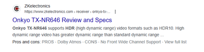

Does anyone know if Onkyo NR-646 supports HLG?

@suzyq10 A Google search suggests - maybe:
But the following post suggests not
Message posted on 04 Jul 2023 10:47 AM
Re: Onkyo
I have a 646 and unfortunately only supports HDR and not HLG or Dolby Vision. For my Sky Q box I have this directly connected to TV and then ARC to Onkyo for audio.

That's a 2015-release model, which would date its specification and manufacture to before HLG was established.

I'm afraid some things need hardware too, and that box would have been produced before silicon supporting HLG was available to manufacturers..

A firmware update won't work as it is a hardware limitation I believe
