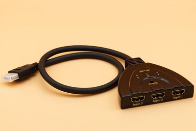

Maybe stick a cheap HDMI switch in between so the handshake is "proxied"

Come to the end of my technical ability now(!!) - what is an HDMI switch?
A hardware device which permits more than one external device to be plugged into a single HDMI port, with a switch (either manual or automatic) to select which is providing input.
