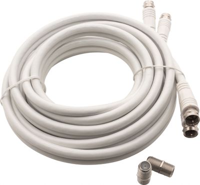

I am building a media wall and moving my sky q from the corner to the middle of the room. How can I extend cable from the wall input to the middle of the room - current cable isn't long enough? Will sky provide an extension or do I purchase online? What connector/ cable do I purchase? Thanks for any support
Re: Cable extension
No
Yes
Twin coaxial RG6 or WF100 with F connections and a pair of F junction barrels.

Re: Cable extension
@Fifitrix49
And always test before sealing the wall up ; )
