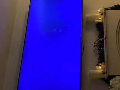

My sky glass to and 2 other tvs with streaming pucks won't load Home Screen, on all 3 all I'm getting is a blue screen saying press home to refresh, I've disconnected from power and Ethernet and left for 5 minutes but still get same message, been in settings and connection is fine as are all other devices internet related

Thank you for your patience, whilst our engineers continue to investigate the problem. They have asked everyone to carry out the recovery process below. If you've attempted this when calling in, please do this again.
Recovery Process for Glass & Stream.
- On your Sky remote, press 4 and 6 together for three seconds. This will reset your remote.
- Switch off the Glass/Stream puck at the mains. There's no need to unplug it.
- Press and hold the Standby button on the bottom of the Sky Stream puck/side of the Glass TV.
4. Keeping your finger on the button, switch the power back on at the mains and wait until you see the LED lights flash different colours, then remove your finger.
5. Let the Glass TV/Stream puck complete the recovery process. This can take up to 15 minutes, depending on your broadband speed.
5. Switch the Glass TV/Sky Stream puck back on and follow the on-screen steps to set it up. For help, see the Setting up Sky Glass article.
