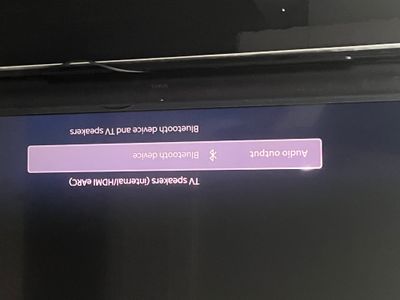

Also
Message posted on 03 Apr 2025 01:50 PM
Re: Problem with sound
I can't see that pic just yet. Perhaps I've mis understood the question though, sorry if I have. Could you rephrase it please?
Message posted on 03 Apr 2025 01:59 PM
I see the pic now, that first option is for eARC. In Settings at the bottom of home make sure the output is set to eARC mode.

@doginhat I think @lettice meant Glass settings rather than Puck.
You do this in Settings at the bottom of your Home Screen.
All Sky Glass TVs have eARC, so you definitely have it. It's port HDMI2 and when enabled as your output settings on the Settings section it will take over from your built in speaker.
Regarding the photo you attached, you'd need to select the top option.
Is there a reason why you are saying your TV doesn't have it? Is it not selectable on the user interface perhaps?
