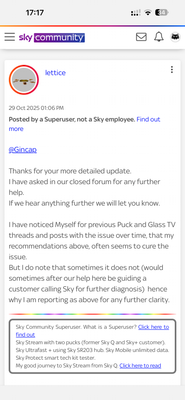

Oh lettice reported back in another thread that there were issues known about and further info appreciated.
I did reply but another user was also having issues that they confirmed as resolved so the post was marked as answered despite me responding as issues remain. Hence this post. If you can't help no problem I'll call Sky in the morning when quieter, I was just hopeful that the problem as lettice suggested is being looked at.

This is what I'm referring to, but no answer.

Did ask.
The OP of that thread I recall did manage to solve their issue.
Sorry, kind of missed continuing with yourself. I apologise for that.
It was seen from words to Sky as a mix of network issues, so was deemed as have possibly being different backend issues.
Sky basically asked to check the same as we are asking here.
As above, not seeing it as a common issue affecting a large amount of customers, it's quite an adhoc issue that crops up now and again and of course can be the result of many variables.
