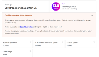

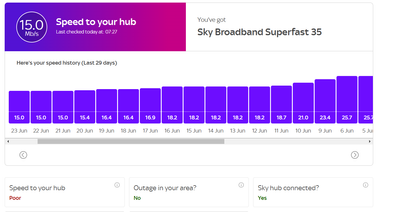

we have a pretty bad line to our house as it is... about a week ago the whole of the area we live lost internet with sky and bt... since then our connection speed of 25 has been dropping by 1 every day... and its now reacing 13mbps... its below the sky speed guarantee for more than a week and cant seem to get anyone on the phone to help...
when we had a BT engineer out last they said to phone sky for some form or line reset that comes from the box that can be done remotely?? is there a way to arrange this online as idk what the reset was called they said todo is?

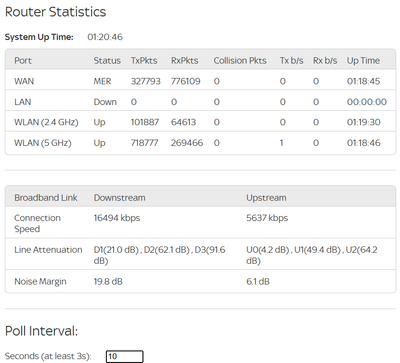

ive added the speed list and the router stats to this post in case its something else

Looks like you reset the hub an hour and twenty minutes ago. DLM will detect this as the continuation of the line fault. Don't reset the hub for 10-14 days since the engineer visit and see if the noise margin decreases and speed increases

A raised noise margin of that high, eg: 19.8dB on DS1 would indicate a fault that needs addressing by an engineer visit, usually when it is that high the fault is near or in the premises. Can you confirm you are using the master socket which is prefiltered faceplate?

The issue is likely at the pole with a poor connection in the junctions box at the pole which the engineer probably didn't check the last time an engineer was assigned.
Recommend Openreach look at the pole for a poor joint.
