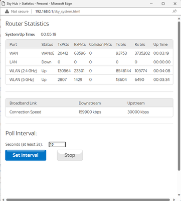

@sally761 So that is not yourself causing the low amount of system uptime on the router. That is you are not powercycling the router yourself?
Message posted on 19 Jan 2024 04:51 PM
Re: broadband keeps dropping out
no i did not touch anything/switch anything off,
i took that screenshot immediately after the last drop in broadband,
Message posted on 19 Jan 2024 05:01 PM
@sally761 Have Sky offered you a replacement router on these phone calls? As it looks like the router is faulty if it is doing a full powercycle. You also have no trouble with power drop-outs in your area?

Update:
Spoke with @sally761 and arranged for hub replacement, please do re escalate should issues persist.
