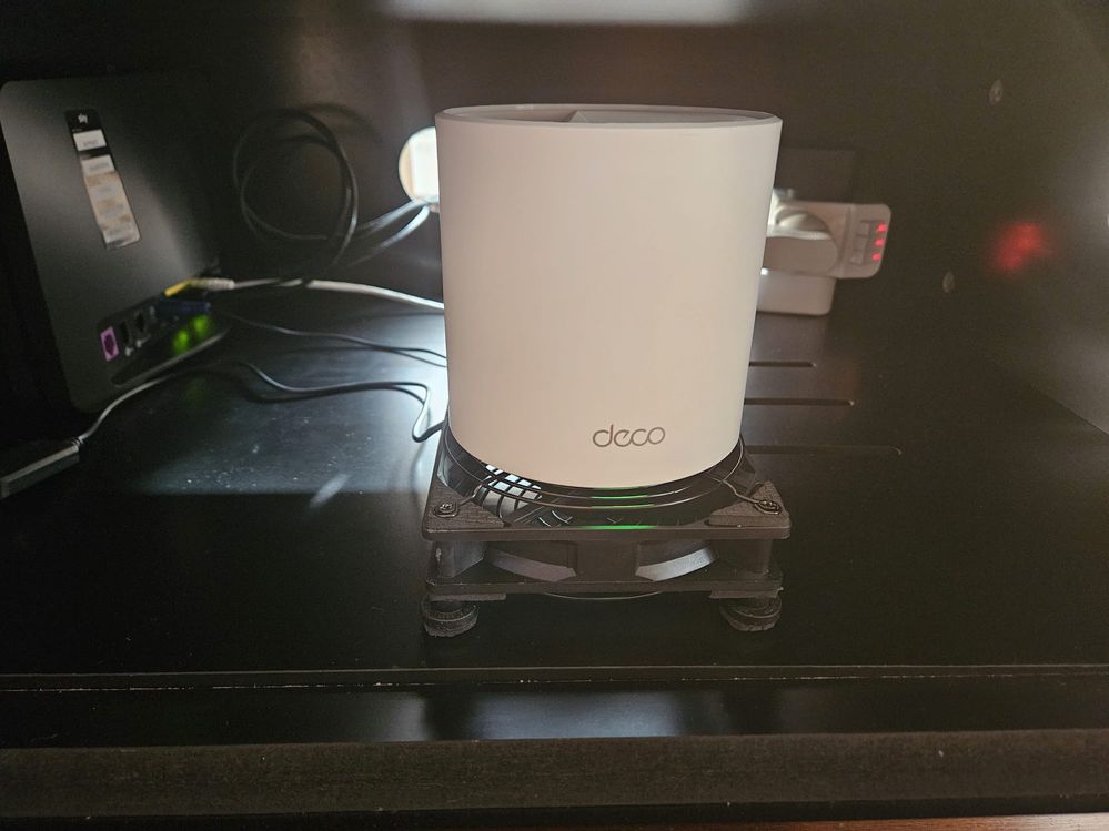

@Ikenna  It did work but my boys were on odd occasions screaming about internet connection when gaming.
I tested TP-AX73 and Deco X50 and both worked direct from ONT for me. But in the end I decided to plug the Sky router back to the ONT and plug the TP-Link to the Sky router. My TP-Link is setup as "Acces point" on the setting.
The Sky router Wi-Fi is disabled so only the TP-Link deals with the WI-Fi. The internet connection seems very stable with this setup.
Also I can monitor the connection of the LED on Sky router if any issues.
As @Chrisee  pointed out it depends on your exchange. But going forward with any ISP I will leave ISP router connected to  ONT and plug my hardware to ISP router.
Here is my TP-Link sitting top of a fan and Sky router in the background all hidden inside a TV cabinet
