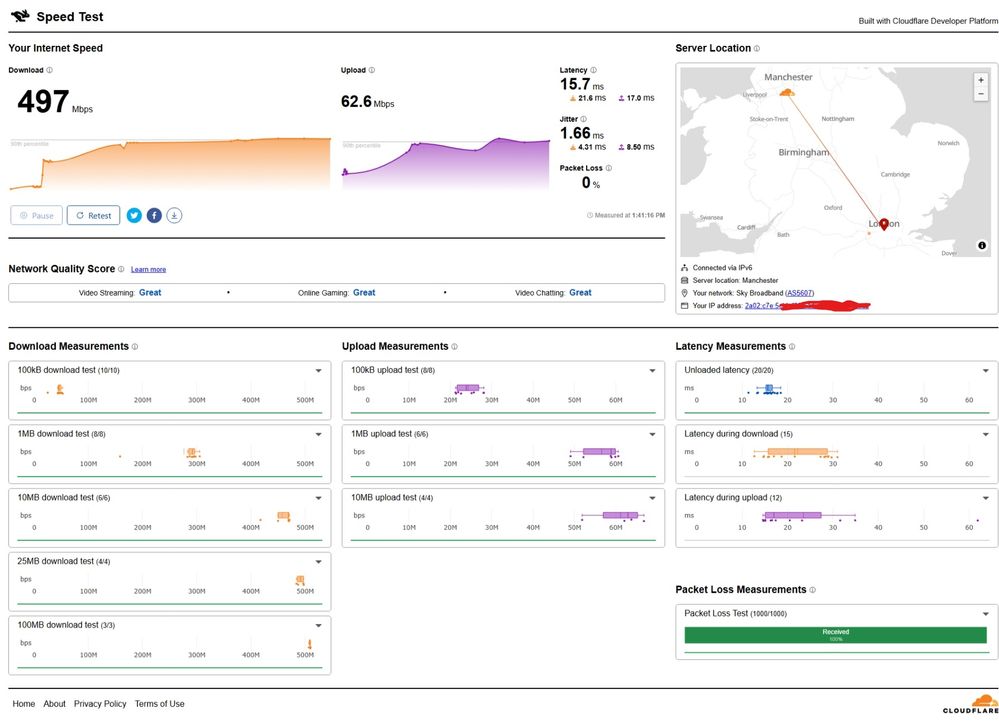

@GordyMcJ SR203, but that test was run against the Asus XT8 connected on the ONT, got a older SR203 one posted that up a couple off day's ago, do you need me to find the link for you! That was from back in April so had for a couple weeks and for sure on the SR203!
Poor Wifi signal and quality with Sky router (SR20... | Sky Community

Hi @JimM1
Thanks for the previous info, and the screenshot of your past speeds. Interestingly, I run the same test via CLoudflare and returned 160Mbs 😞
