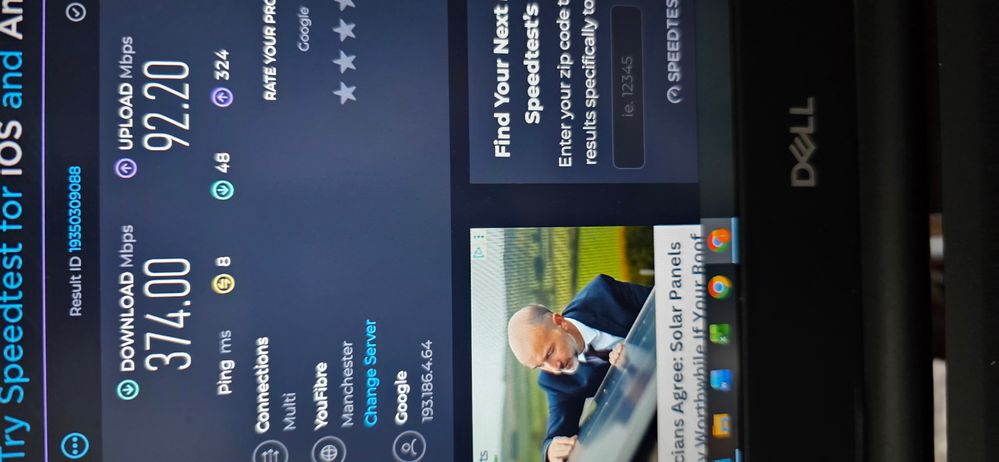

This is from the PC on Ethernet - surprisingly it has gone up a little!
The Ethernet adapter on the laptop says 100mpbs (but the controller on the laptop model goes UP TO 1gb).
This is a work laptop that I don't have access to modify or change any parameters but my main issue is the PC and not getting the speeds.
With my S25 Ultra I get 422Mbps which leads me to think it is the router itself which has an issue?

To me it doesnt look like there is anything wrong to be honest
- Your S25 seems to be getting very reasonable speeds for WiFi so not an issue there
- Your work laptop is locked down and could be running all manner of things that slow the network down on it like VPN, scanning tools, anti virus etc so its not an accurate test

@ianmclean1984 In your 2nd post, the 2nd picture (the 1st has been rejected for some reason) has the caption "This is from the PC on Ethernet...", is that correct as it looks to be a Dell laptop?

The second picture with the Dell showing is the laptop - not PC (apologies).
