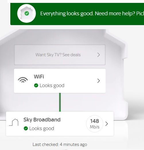

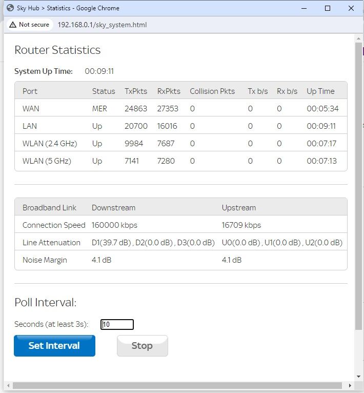

Over the last 10 days, similar things are happening. The Internet would drop, and I have to re-connect my laptop about 6-8 times a day. I have SR204 and you can tell when this happen when all the lights goes off. Then Power goes green, after a while voice turns orange, and the Internet takes 70 seconds before blinking orange - before turning green! I've started connecting to my mobile internet when having a Zoom meeting to avoid this interruption of about 90-120 seconds. below is the diagnostic and statistics.
sky.com/help/diagnostics/sky-broadband-diagnostic/sky-broadband-diagnostic
