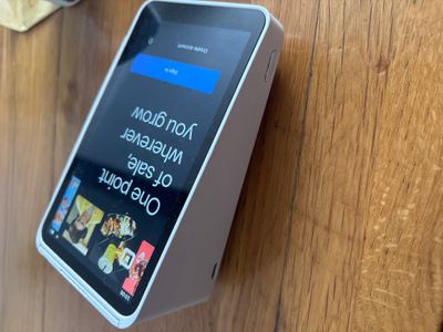

I've just had a Sky Max Hub and my Square Terminals (used to take orders and payments) appear to connect with an excellent signal but in fact won't connect at all, almost as if they are incompatible with the router. Have tried them on a friend's Sky network (not Max Hub) and they work fine.
has anyone else experienced this issue?

Interestingly it was the default WPA3 that was causing the problem, switched to WPA2 and all is fine.
